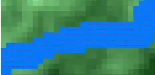

I'm working on a top-down tile-based fairly graphical 2D game inspired by Dwarf Fortress. I'm at the point of implementing a river in the game world, which covers a number of tiles, and I've calculated the flow direction for each tile, as shown below by the red line in each tile.
Example of river tiles with directions

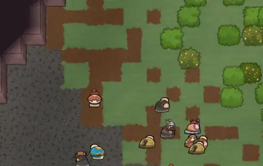

For reference of the graphical style, here's how my game looks currently:
In-game shot of graphical style
What I need is some technique to animate water flowing in each of the river tiles, so that the flow blends into the surrounding tiles so that tile edges are not apparent.
The closest example I have found to what I am after is described at http://www.rug.nl/society-business/centre-for-information-technology/research/hpcv/publications/watershader/ but I'm not quite at the point of being able to understand what's going on in it? I have enough of an understanding of shader programming to have implemented my own dynamic lighting but I can't quite get my head around the approach taken in the linked article.
Could someone explain how the above effect is achieved or suggest another approach to get the result I want? I think part of the above solution is overlapping the tiles (though I'm not sure in which combinations) and rotating the normal map used for the distortion (again no idea on specifics) and past that I'm a bit lost, thanks for any help!

  • @YoshSynergi I want the river flow to be in any direction rather than 8 directions, and I want to avoid having visible boundaries between the tile edges, similar to the result achieved in the linked shader – Ross Taylor-Turner Nov 03 '17 at 10:29
