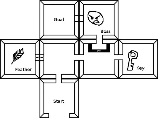

I'm working on a game with maps that resemble lock and key puzzles. The AI needs to navigate to a goal that may be behind a locked red door, but the red key may be behind a locked blue door, and so on...
This puzzle is similar to a Zelda-style dungeon, like this picture:
Zelda dungeon
To get to the Goal, you must defeat the Boss, which requires going over the pit, which requires collecting the Feather, which requires collecting the Key
Zelda dungeons tend to be linear. However, I need to solve the problem in the general case. So:
  • The goal could require one of a set of keys. So maybe you need to get either the red key or the blue key. Or there could be an unlocked door the long way around!
  • There could be multiple doors and keys of a kind. E.g. there could be multiple red keys in the map, and collecting one will grant access to all the red doors.
  • The goal may be inaccessible because the right keys are behind locked doors
How would I perform pathfinding on such a map? What would the search graph look like?
Note: the last point about detecting inaccessible goals is important; A*, for example, is extremely inefficient if the goal is inaccessible. I would like to deal with this efficiently.
Assume that the AI knows where everything is on the map.

Standard pathfinding is Good Enough -- your states are your current location + your current inventory. "moving" is either changing rooms or changing inventory. Not covered in this answer, but not too much additional effort, is writing a good heuristic for A* -- it can really speed up the search by preferring to pick up things over moving away from it, preferring to unlock a door near the target over searching for a long way around, etc.
This answer has gotten a lot of upvotes since it came first and has a demo, but for a much more optimized and specialized solution, you should also read the "Doing it backwards is much faster" answer https://gamedev.stackexchange.com/a/150155/2624
Fully operational Javascript proof of concept below. Sorry for the answer as a code dump -- I had actually implement this before I was convinced it was a good answer, but it seems pretty flexible to me.
To start off when thinking about pathfinding, remember that the heirarchy of simple pathfinding algorithms is :
  • Breadth First Search is about as simple as you can get.
  • Djikstra's Algorithm is like Breadth First Search but with varying "distances" between states
  • A* is Djikstras where you have a 'general sense of the right direction' available as a heuristic.
In our case, just encoding a "state" as a "location + inventory" and "distances" as a "movement or item usage" allows us to use Djikstra or A* to solve our problem.

So, how do we add items and keys to this code? Simple! instead of every "state" begin just the room number, it's now a tuple of the room and our inventory state:
 // Now, each state is a [room, haskey, hasfeather, killedboss] tuple
function State(room, k, f, b) { this.room = room; this.k = k; this.f = f; this.b = b }
Transitions now change from being a (cost, room) tuple to a (cost, state) tuple, so then can encode both "moving to another room" and "picking up an item"
// move(3) keeps inventory but sets the room to 3
var move = room => new Transition(1, new State(room, cur.k, cur.f, cur.b))

Backwards A* will do the trick
As discussed in this answer to a question about forward vs backward pathfinding, pathfinding backwards is a relatively simple solution to this problem. This works very similarly to GOAP (Goal Oriented Action Planning), planning efficient solutions while minimising aimless wondering.
At the bottom of this answer I have a break-down of how it handles the example you gave.
In Detail
Pathfind from the destination to the start. If, in your pathfinding, you come across a locked door, you have a new branch to your pathfinding that continues through the door as if it is unlocked, with the main branch continuing to look around for another path. The branch that continues through the door as if it's unlocked is no longer looking for the AI agent -- it's now looking for a key it can use to pass through the door. With A*, its new heuristic is distance to key + distance to AI agent, instead of just distance to AI agent.
If the unlocked-door branch finds the key, then it continues looking for the AI agent.
This solution is made a little more complicated when there are multiple viable keys available, but you can branch accordingly. Because the branches have a fixed destination, it still lets you use a heuristic to optimise the path-finding (A*), and impossible paths will hopefully be cut off quickly -- if there's no way around the locked door, the branch that doesn't pass through the door runs out of options quickly and the branch that goes through the door and looks for the key continues on its own.
Of course, where there are a variety of viable options available (multiple keys, other items to circumvent the door, long path around the door), many branches will be maintained, affecting performance. But you'll also find the fastest option, and be able to use that.
In Action
In your specific example, pathfinding from the Goal to the Start:
  1. We quickly encounter a boss door. Branch A continues through the door, now looking for a boss to fight. Branch B stays stuck in the room, and will soon expire when it finds there's no way out.
  2. Branch A finds the boss and is now looking for the Start, but encounters a pit.
  3. Branch A continues over the pit, but now it's looking for the feather, and will make a bee-line towards the feather accordingly. Branch C is created which tries to find a way around the pit, but expires soon as it's unable to. That, or it gets ignored for a while, if your A* heuristic finds that Branch A is still looking most promising.
  4. Branch A encounters the locked door, and continues through the locked door as if it's unlocked, but now it's looking for the key. Branch D continues through the locked door as well, still looking for the feather, but then it will look for the key. This is because we don't know if we need to find the key or the feather first, and as far as the pathfinding is concerned, the Start could be on the other side of this door. Branch E tries to find a way around the locked door, and fails.
  5. Branch D quickly finds the feather and continues looking for the key. It's allowed to pass through the locked door again, since it's still looking for the key (and it's working its way backwards in time). But once it has the key, it won't be able to pass through the locked door (since it couldn't pass through the locked door before it found the key).
  6. Branch A and D continue to compete, but when Branch A reaches the key, it's looking for the feather, and it will fail to reach the feather because it has to pass through the locked door again. Branch D, on the other hand, upon reaching the key, turns its attention to the Start, and finds it without complication.
  7. Branch D wins. It has found the reverse path. The final path is: Start -> Key -> Feather -> Boss -> Goal.
