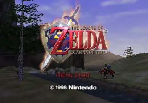

I'd like to recreate a flaming effect like the one from the logo on the title screen of the N64 game 'The Legend of Zelda: Ocarina of Time,' shown below:
A quick look into the textures used in the ROM provide a single 32x32 texture that looks similar to the effect but I don't know how that image (assuming that's the right one) is transformed into the effect seen on the logo.
How can I implement something similar?

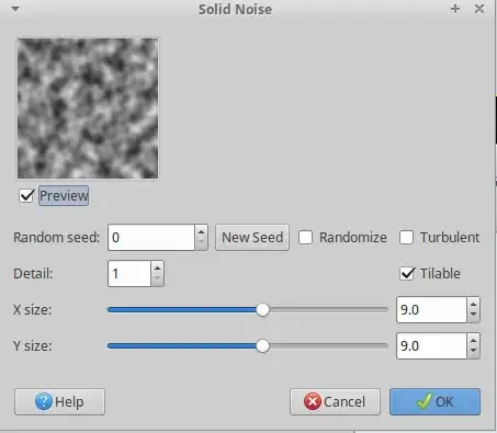

Then create a repeating (tileable) solid noise texture (GIMP used here)
noise texture

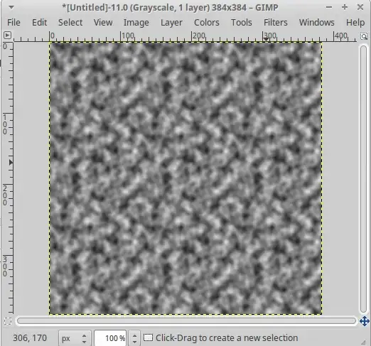

Use the Map->Tile... filter to create a 3x3 tiled pattern (in this example, 128x128 x 3 = 384x384) for the next step to ensure our texture is still repeatable - we'll keep only the center part.
previous image tiled 3 by 3

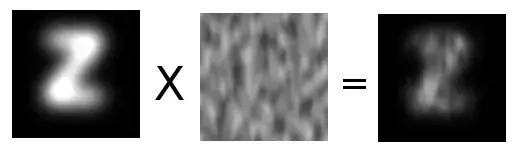

Use Blur->Motion Blur... to blur the texture upward and keep only the center 1/3rd (back to 128x128)
noise plus motion blur
Multiply both textures together on the GPU and use this for opacity.
mask combined with noise
