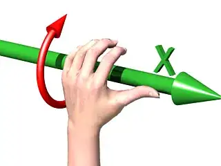

You got it backwards, the rotation direction defines the handedness.
Take both of your hands and point with your thumbs in the positive direction on the X axis. Now make an "OK" gesture with your hands without rotatong it, now the otjer fingers define a circle. If the fingers on the left hand point in the same direction as the direction of rotation around the X axis, then the coordinate system is left handed, otherwise it's right handed.
The same in a picture:

  • this is not answer the question, i mean why someone provide this rules, why positive direction of rotation is different and not same for both systems? – max333 Aug 08 '17 at 20:07
  • @MaxFrei It simply depends on which axis points upwards, the Y (right handed) or the Z (left handed) – Bálint Aug 08 '17 at 20:32
