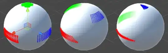

Euler angles aren't necessarily a good way of expressing limits over arbitrary ranges, as their behaviour close to zero is very different from their behaviour away from zero.
Below I've visualized the forward, right, and up vectors of an object rotated with Euler angles over various ranges.
Here yaw ∈ [-50, 50] and roll ∈ [-10, 10]. From left to right, I gradually alter the pitch range, from pitch ∈ [-10, 10] to pitch ∈ [70, 90]. You can see I haven't reduced the range of allowed angles anywhere, only shifted where it starts.
Example of Euler rotation ranges visualized
And yet, when we look at the range of orientations allowed in these ranges, we can see all three axis regions distort and change size & shape. The allowed range of right vectors flattens toward a line, the forward vectors collapse toward a triangle, and the up vectors spread out in a wider arc.
So limits specified in Euler angles are error prone. If the ranges of allowed rotation you actually want look like this, for example:
The first range, rotated in a more intuitive way
...then there might be no combination of Euler min/max angles that corresponds to this shape.
For narrow Euler angle ranges, we can ameliorate this a bit by choosing a neutral orientation that corresponds roughly to the middle of our range, and then measure our Euler angles as relative deviations from this. This will tend to keep our min & max close to and symmetric about zero, where Euler angles are most intuitive.
