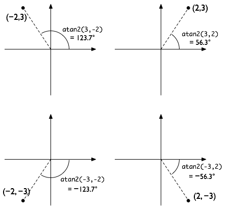

atan2 diagram
(diagram courtesy of gareth, please vote up his answer too)

    It's worth noting Wikipedia describes other usages for Atan2 (not atan) than just avoiding the division by zero. For instance, it corrects itself for the quadrant being used, where normally you'd have to do all that yourself. – doppelgreener Jul 09 '11 at 06:17

However, when performing y/x, calculating 3/4 gives the same answer as calculating -3/-4. Likewise -3/4 gives the same answer as 3/-4. So we have atan2(y,x) that handles the individual signs correctly and prevents a divide-by-zero/infinity error.
  • Ɵ = atan2(y,x)

Atan2() is needed as atan() doesn't tell you the angle from the horizontal you need as it doesn't cope with quadrants.
This means that using atan for vectors (-2,2) and (2,-2) will give the same value. You would then to switch on the sign of yours arguments and add pi to the result. In addition, you have the divide by zero special case to consider that Jesse mentioned. Also atan2() works better than atan when x is close to 0
So you if you want the angle of a vector between -pi and pi
