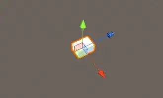

Your diagnosis of the problem is incorrect. Unity handles negative angles just fine, as you can see here:
Animation showing a cube in Unity wandering in a figure-8 shape.
The problem is how you're calculating your rotation increment. As described above, Time.deltaTime is the time in seconds that have elapsed since the last frame (typically 1/60 - 1/30). As long as your framerate holds steady, this value is nearly constant. It's good for scaling change over time to keep a consistent rate, but it doesn't itself progress over time.
If you want something to change over time, then you'll want to either:
Here's the code used above. You can see just like yours it rotates each frame by an increment that's scaled by a sine function. In this one though, the sine varies over Time.time, so the phase progresses from frame to frame
