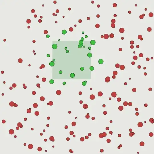

Here is a visual demo I created for that algorithm. I modified it to work with circle objects. In the demo picture I have already set the powerOfTwo attribute to 9, which is pretty big. The green circle is my mouse position. The red circles are those entities within my player's interested area. But this is not a good solution. The player should be able to see things on all directions around itself and stretch out further to about the same size of the rectangle area holding those red circles.

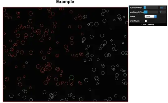

The library you're using should do what you want. I tried it — demo here, with the default power of two setting (5):
demo of spatial hash library
You have to specify the “area of interest” in the retrieve function. The library wants retrieve to take a rectangle, so pass in a rectangle centered on the player.
