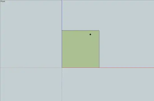

Imagine you have two planes that are perpendicular to the camera (both facing the camera). The green plane is closest and the red plane behind that. From the camera view it looks like this:
Camera perspective view
Now when I cast a ray out to the black dot, to do so correctly in perspective projection, I have to cast from where my camera is (which is the sharp point on the left) out to the dot. That's what the extra math does when creating the vector for the ray.
View of perspective camera
If I were to do the same in parallel projection, I can pretend that my camera is not a pin-point, but a huge plane. Here is where I can use the vector[0,0,-1]:
view of parallel camera
Here's the same view as the top image, but in parallel projection. enter image description here
Anyway I'm pretty sure that's your issue. It's not a mathematical answer, but I hope it helps you understand the difference in what you were thinking and how it's supposed to work. There is of course the Math SE that you could get more details on the math.
