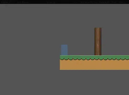

In my latest game I'm making, you can slice a 2D object arbitrarily, demonstrated in this gif:
You can continuously cut it into hundreds or thousands of pieces. This doesn't create a lot of lag, because they're always in a sleeping physics state, but there's a problem when you cause them to move.
I'm not really sure how to deal with making it so there's not so much rubble from cutting something apart. I don't really want to delete them after a certain amount of time; I don't like how, if you go back to something you cut up after a while, it randomly disappeared.
How can I clean up excessive player-created rubble?

    It's not really clear from your question what you actually want. You say you want to "clean up the rubble", but at the same time you say you don't want rubble to disappear after a while. – Philipp Jun 26 '17 at 10:41
    Tiny & Big would destroy the smaller pieces. Pretty sure the larger pieces stayed around for the level, but I don't fully remember it. Here's an example: https://youtu.be/236ly0ApPqg?t=177 – TyCobb Jun 26 '17 at 19:44
    Stuff that's out of range can be removed and replaced when you come back to it. – Loren Pechtel Jun 27 '17 at 03:33
    Just my little opinion, but set a minimum object size to be effected by the cut action. If it's hard to single out the piece you're cutting, then you can't cut it. (Just aside, nice game dynamics, this one's definitely got legs!) – AJFaraday Jun 27 '17 at 15:05
  • You should definitely show an update of how it progresses if you get what you're aiming for. That and I want to see if that rectangle eventually becomes a character that has mind powered wood chopping abilities :) – n_plum Jun 27 '17 at 15:36

Figure out your bottleneck
A few hundred moving objects should not be a problem. However, a few hundred colliding objects might be. It will take some testing, yet I believe the bottleneck you have are the collision.
By the way, about how many objects are we talking? What is the platform? A hundred objects for a mobile game is not the same as a hundred for a web game or a hundred objects for a desktop game.
Test the same game but with collisions between the cut objects disabled, and see if you get it to lag on similar amounts of objects. If that is the case, it means that the sheer amount of objects is the cause of trouble; otherwise, the collisions are the problem.
This will inform your decision on what you will do to improve performance. Not all of the ideas below will apply, and you will need testing anyway.

I believe that when it comes to cleaning up rubble, the first thing to have is to remove objects that are out of bounds. For example, the piece that fell to a pit. If there is no way the player should be able to get there to see it, there is no reason to keep it around.
I will come back to this.
Make it more realistic (part 1)
When you cut wood with a saw, axe or similar tool, there will be lost material (to sawdust, shavings, etc). Even if you cut with a laser, the laser will burn some wood. In addition, for thing that are not wood there will usually be deformation around the cut, crumbling, etc.
What I am saying is that the cut is not perfect, and some material will be lost. You can model that in your game. That magic cutting red thingy has thickness. Remove that thickness from the objects (add particle effects if you feel too guilty).
This means that you will not be able to cut anything that is smaller than that thickness, in fact, attempting to do it will remove it from the game. That is good! It means that there is an upper bound the amount of rubble that there will be, and there is mechanically sound way to clean it up in game.

    Attempting to cut an object smaller than the beam width need not cause the object to disappear altogether but might instead yield one smaller object. What's important is that the number of objects can only be increased if the cut object exceeds the beam width. – supercat Jun 26 '17 at 15:15

First of all, that game mechanic looks like it could be super fun, so congrats on thinking of it! Here are two simple solutions that could be used independently or together to solve this particular issue:
Remove Very Small Pieces
There isn't much of a point to keeping around tiny pieces of collision that really won't impede the player or have any real effect on the environment. Calculating the extra collision logic simply isn't worth it, so either remove these pieces or remove collision on them.
Limit Player Cuts
Having unlimited cuts could potentially make a lot of your puzzles really simple if you can just slice every impeding object into a pile of mush. Give the player only a few cuts to play with (or make it slowly recharge over time) and you'll likely find that it makes your puzzles more challenging in addition to eliminating the pains of dealing with collision on a thousand fragments.

    Think I'll do the first one since I'm not planning to make any kind of puzzle game. – Garflington Jun 26 '17 at 18:31

The world is discrete. You can't render an object smaller than a pixel, so don't allow such objects to exist. (This is similar to some of the realism points made by Theraot.)
Indeed, you might get this for free: the player specifies their cut line as essentially a discretized line on the screen. The effect of the cut is to divide every object into the sub-objects consisting, respectively, of the pixels on or below that line, and the pixels strictly above it. A one-pixel object can't possibly be both above and below the line, so it can't be cut by this algorithm.
If cutting all the cuttables into individual pixels would still leave you with too many objects to track, a larger minimum size might still work.
Or just don't worry about it. If the player is prepared to spend a long time cutting objects into dust, they're obviously not in a hurry so they can deal with the lag they caused. ;-)
