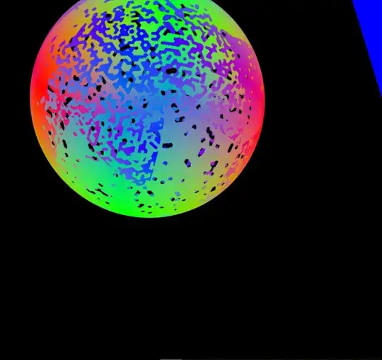

I've noted that if in the perspective camera I put near plane to a low number like 0.000001 and far plane to 1000 my render has some problems, like strange depth artifacts (see images below) or division by zero during the unprojection procedure.
I'm not very skilled in math but there should be something strange because if I put near plane at 0.1 everything is working as expected.
Is there any mathematical limitation to the near plane value I'm not aware of?

The GPU uses more bits to store distances closer to the camera than ones farther, and this becomes worse the closer you set the near plane to 0. With a near plane of 0.01 the error between the stored distance and actual distance at 1000 units becomes 100 unit.
What happens basically is that different distances start to have the same value in the depfh buffer, so the GPU can't decide which one goes on top, and z-fighting happens.
You should always set the near plane to the largest value you're comfortable with.
