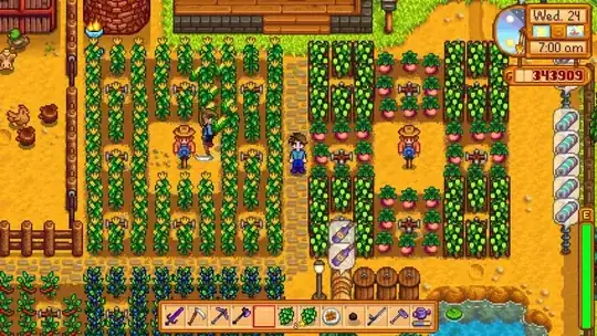

Take stardew valley for example, in the image below you can clearly see that the player is not square. The creator of the game said he made everything in 16x16, but then how is there so much detail in the characters? Surely you do not patch several 16x16 squares together to make a character (as you would with a tilemap)?
What is the "common" way of dealing with things that are not square, like the characters in the image. Do you just make 16x32 sprite and set PPU to 16? Wont that make it look a bit weird next to 16x16 sprites? Do you generally pick one size (i.e 16, 32, 64) And then stick to that for everything in the game?

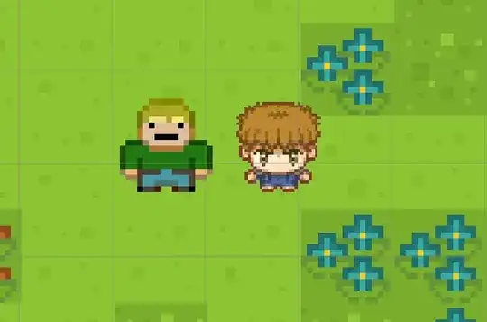

The visual Issue I've seen is this, where a 32x32 sprite looks very out of place (too sharp) next to a 16x16 sprite.
So I am wondering, how do you mix sizes wihout getting this effect where one image looks much sharper than the other. If I for example wanted a character to be 16x32, or any non-square value, when my tiles are 16x16

    PPU has nothing to do with the texture dimensions of your sprites, it just decides the scale at which they're displayed relative to your world coordinate system. Two sprites with the same PPU will show the same pixel density (ie. the displayed size of each pixel block will be the same from one sprite to the other when viewed straight-on), even if the images have completely different sizes. So I'm not sure what you mean by "won't that make it look a bit weird" — can you elaborate on exactly what visual issue you've observed? – DMGregory May 25 '17 at 19:28
  • @DMGregory Sure, let me upload an image – Green_qaue May 25 '17 at 19:29
    The effect shown in your example screenshot will happen if you put two images together with different PPU values (or if one image has its pixels doubled/tripled in the texture itself, or you've applied a scale to one image but not the other). If you stick to one consistent PPU value and don't scale your sprites then you'll keep a consistent pixel density – DMGregory May 25 '17 at 19:39

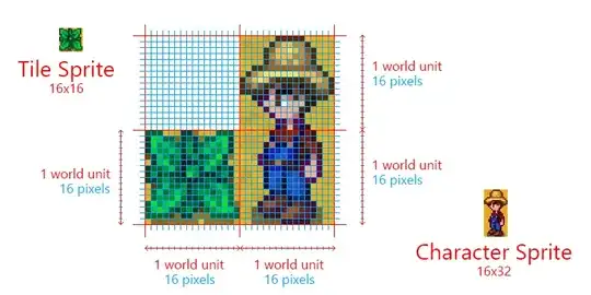

Summarizing the points above, what matters for two pieces of pixel art to match is that their pixel density (texels per screen area / world unit) is the same.
Using some sprites from Stardew Valley as an example, we can see that even though the sprites have different texture dimensions, they match up on a consistent grid because each pixel is drawn the same size.
Example showing two different sized sprites at the same pixel density.
If we think of the size of the plant as one tile / one unit of world space, we can see this unit spans 16 pixels horizontally and vertically. The character, having twice the height of the plant, also covers twice the number of tiles / world units, so the density of pixels stays the same at 16 pixels per world unit.
