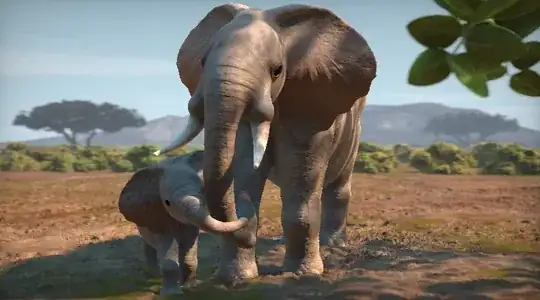

You'll see this technique used in many Shadertoy examples too, like these elephants, again by Íñigo Quilez (warning - this link is pretty taxing on the browser)

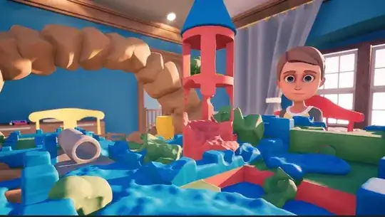

Claybook takes this a step further by baking a signed distance field into a 1024 x 1024 x 512 pixel volume texture, to 1/32 voxel precision, and raymarching through that volume in the shader. This limits the detail that can be achieved and the size of the world you can create, but sidesteps the three downsides I listed above.
In this screenshot, the blobby shapes in the foreground are rendered as a raymarched SDF, while the character and room in the background are more conventional polygonal rendering.

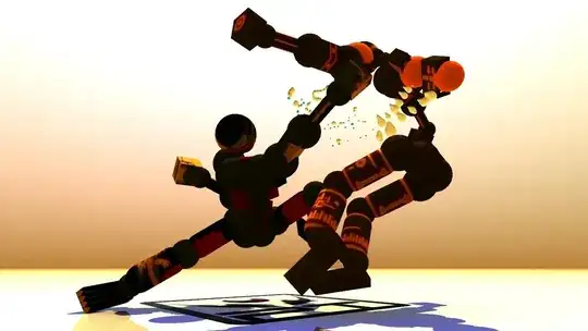

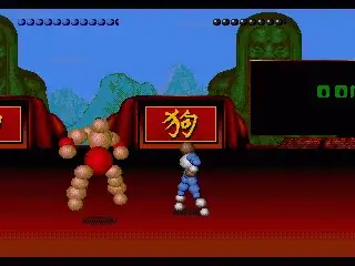

It's possible to build a graphics engine using other geometric primitives. In 1994, Accolade released a 3D fighter called Ballz used spheres. It was impressive for the hardware at the time & notably different from other things available on console, but didn't do particularly well as a franchise. The underlying engine was later used for a number of virtual pet games.

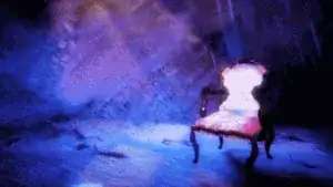

Ecstatica & Ecstatica 2 (released by Psygnosis in 1994 & 1997 respectively) primarily used ellipsoids. I didn't play either of these, but again recall that they looked distinctive.
A more recent example is Toribash, which appears to use a combination of spheres, cylinders, cones & polygons.

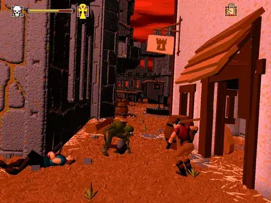

The most common alternative to describing 3D world in terms of polygons are various voxel based techniques. Voxels are to 3D as pixels are to 2D. You can construct a 2D picture using vector graphics, or pixels. Similarly you can create 3D world using polygons or voxels.
One way of doing voxels is popularized by Minecraft. You divide 3d space into smaller portions using cubes and give each cube a color/transparency - similarly like you did in 2D picture dividing it in small squares. If the cubes are large, you can assign them a texture instead of one color.
A variant of this technique was already mentioned - signed distance fields. It works by dividing space with 3D planes. At cross-section of three planes there is a unique point. This can be visualized as a uniform mesh of points floating in the air. You assign a number to each point. If you want to determine the properties of a point in 3D space, you sum up values in close proximity and for example if it is above certain threshold, you treat the point as solid. Positive numbers "project" solidity around, negative project "opaque". What the world looks like is determined by computing cross-sections of many values.
Cube engines reverse that approach. You take a finite cube of 3D space which will be your world. You divide this cube into 8 smaller cubes, and mark each whether it is opaque, solid (which color/texture/slant/round) or is subdivided. If the cube is subdivided, you mark each one of 8 subdivisions, whether it is opaque, solid or is subdivided. Rinse, repeat. The world is described with a tree structure of such subdivisions. There is no (theoretical) limit to these subdivisions, so you can always make the smallest voxel even smaller and add more detail. You can check tesseract.gg for the latest engine in the line, to see what can be accomplished.
2Note that although Minecraft is logically built from voxel data, in most versions the visible voxel faces are baked out to polygon meshes for rendering. See all the triangles visible here. What you describe as SDF sounds more like metaballs sampled on a discrete grid, possible related to marching cubes. Numbers in SDFs represent the distance of a sample point from the surface (with ± = inside/outside) , not solidity/opacity/density. SDFs don't always need to use a discrete grid, although they can (as in the Claybook example in my answer). – DMGregory Apr 25 '23 at 21:14
There are a couple games that use "pure" voxel rendering without converting the voxel data to polygons first. Like the 1992 Comache or the 1999 Outcast. – Philipp Apr 26 '23 at 14:44
