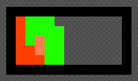

Humor me as I attempt to elaborate on my perspective with the help of polyominoes.

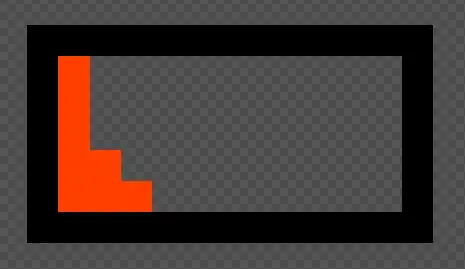

Suppose we have some fixed boundaries set by the framework or engine we're working with.
We then proceed to create our first layer/module of the game like so.
Moving onwards we build our second layer/module.
At this point, we might notice that there is some space available between the two modules and we might be tempted to optimize it to make full use of the boundaries allotted to us.
Perfect, now the application is fully utilizing the resources available to us, the application is better, good right?

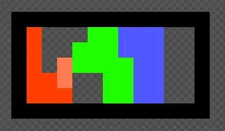

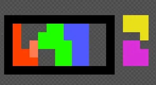

We proceed to build the third layer/module of our application and suddenly we come to a realization (perhaps even one we could not have foreseen during initial planning) that the 3rd layer/module is not working for us.
We search for an alternative, we find one, and in the end, this also requires us to change the 2nd module of our application since it's incompatible with our newly selected 3rd module. (Thankfully it's somewhat compatible with our 1st module so we don't have to re-write everything from scratch.)

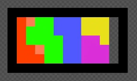

So we put it all together...
Hmm, can you see what happened?
By optimizing too early we now have actually made things worse efficiency-wise since what we optimized against is not what we ended up with down the line.

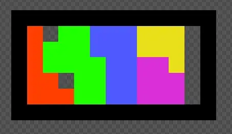

If, however, we would have opted to wait with our urge to optimize it immediately we would have ended up with something like this:
And now if we perform the optimization at this point we get something satisfying to look at.
