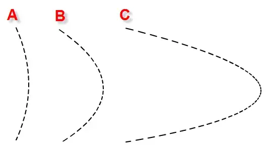

Sadly the points are unevenly distributed, as you can see in the dashed-line rendering below. The points are denser in the middle of the curve, and are further spaced apart near the edges. How can I calculate a evenly distributed set of points along a quadratic bezier curve?
Please note that I'm using this for rendering a dashed line, so a slow solution in MATLAB or something will not do. I need a fast solution that will fit inside a renderer. This is not for research or a one-off calculation!
dashed
Edit: I'm not asking how to accomplish the above. The above is MY RENDERING! I already know how to estimate the length of a bezier, calculate the number of points, etc, etc. What I need is a better bezier point interpolation algorithm since the one I have calculates points unevenly distributed along the curve!
