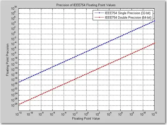

Regarding Precision:
As pointed out by @James Hollis, it's possible that the system representing the number is filling in the remaining digits to give an illusion of precision.
The higher an IEEE754 number gets in terms of magnitude, the worse its precision gets. This relationship is near-linear as demonstrated with this diagram (that I shamelessly borrowed from Wikipedia).
IEEE754 Precision/Value Correlation Graph
The typical way this behaviour manifests is by small ammounts of imprecision. An example in C++:
void main(void)
    static_assert(sizeof(float) <= 4, "");
    for (float f = 0; f < 1; f += 0.01f)
        std::cout << f << ", ";
    std::cin.get();
On my computer this runs fine up until 0.83, after which the numbers deteriorate:
0.839999, 0.849999, 0.859999, 0.869999, 0.879999, 0.889999, 0.899999, 9, 0.909999, 0.919999, 0.929999, ...
These sorts of errors soon mount up. Thankfully in the majority of games these small errors aren't large enough to impact gameplay. The only time the errors become a problem is when trying to do comparisons, because 0.899999 may or may not be equal to 9. Thankfully most languages provide an epsilon value that represents the smallest amount of deviation that can be attributed to expectd error from imprecision.
As @Jack Aidley notes though, this can cause an issue in games where vastly varying scales are present (scales ranging from values in the order of 4 decimal places to values in the millions or billions). In some cases these are unavoidable because (for example) physics involves both incredibly large forces and incredibly small forces. Worst case scenario: you fail to correctly intercept an missile and people die.
