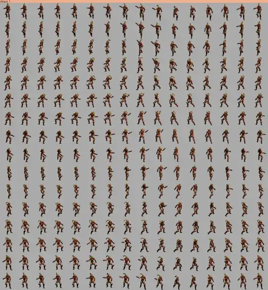

  1. Typically there are less than 360 directions. Common case is 8 or 16. Animations are quite short too.
  2. Automation is your friend. Write a Blender/3DMax/etc script to load a model from the list, render it in every required frame and direction to an image. Tag images according to content and address them from the game.
  3. Pack everything into texture atlases (aka sprite sheets) for faster access.
In the end, you will end up with several throusands of sprites, neatly packed into just dozen of atlases. Not such a big deal ;)
I could not find an image from CoC, but here is Diablo II, which used the same approach to characters animations. E.g. Amazon melee attack:

    The balance of rendering power/time versus storage space and download time. – M. Mimpen Mar 14 '17 at 10:29
    What is an "atlas"? Any link? – BЈовић Mar 14 '17 at 12:27
    @BЈовић Look for "Texture Atlas". It's very common concept. – Kromster Mar 14 '17 at 12:40
  • @BЈовић old fashioned name for a map. Like an atlas of the earth. This is a mapping of the sprite. – user64742 Mar 15 '17 at 06:44
    It may be worth noting that in discussions of this technique by developers of Blizzard North, they basically came to the conclusion that it was a weird stop-gap measure to handle an awkward moment in PC graphics capabilities, and even then it didn’t really end up being worth it. There was an interview about it, and in the end it took so much time to re-render everything that the general conclusion was that it was not a great approach (and their next game would definitely be 3D). – KRyan Mar 15 '17 at 12:11
    @KRyan good addition! I'd guess it was due to VAST amount of NPCs and gear in the D2. For CoC and mobile platforms that's a different balance. – Kromster Mar 15 '17 at 12:16
