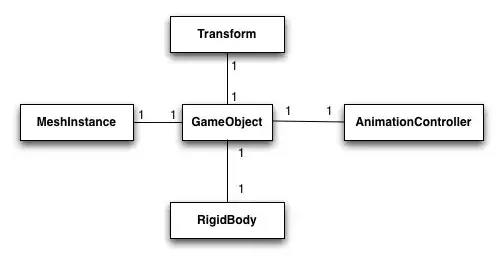

The component architecture is an alternative to avoid the large hierarchies that are achieved inheriting all elements from a same node, and the problems of coupling that leads.
You are showing a component architecture with "generic" components. You have the basic logic to attach and detach "generic" components. An architecture with generic components is more difficult to achieve because you don't know which component is. The benefits is that this approach is extensible.
A valid component architecture is achieved with defined components. With defined I mean, the interface is defined, not the implementation. For example, GameObject can have a IPhysicInstance, Transformation, IMesh, IAnimationController. This has the benefit that you know the interface and the GameObject knows how to deal with each component.
Responding to the term over-generalizing
I think that the concepts are not clear. When I say component, doesn't mean that all component of a game-object must inherit from a component interface or something similar. However this is the approach for Generic Components, I think that it is the concept that you name as a component.
The component architecture is another of the architectures that exist for runtime object model. It's not the only and its not the best for all cases, but the experience has demonstrated that has a lot of benefits, like low coupling.
The main feature that distinguishes the component architecture is convert the relation is-a into has-a. For example a object architecture is-a:
is-a architecture
Instead of a object architecture has-a ( components ):
has-a architecture
There is also property-centric architectures :
For example, a normal object architecture is like this:
  • Object1
    • Position = ( 0, 0, 0 )
    • Orientation = ( 0, 43, 0 )
  • Object2
    • Position = ( 10, 0, 0 )
    • Orientation = ( 0, 0, 30 )
A property-centric architecture:
  • Position
    • Object1 = ( 0, 0, 0 )
    • Object2 = ( 10, 0, 0 )
  • Orientation
    • Object1 = ( 0, 43, 0 )
    • Object2 = ( 0, 0, 30 )
It is better the object model architecture? In performance perspective, it's better the property-centric because it is more cache-friendly.
Component is refered to the relation is-a instead of has-a. A component can be a Transformation matrix, a quaternion, etc. But the relation with the game-object is a relation is-a, the game-object doesn't have the transformation because it's inherited. The game-object has ( relation has-a ) the transformation. The transformation is then a component.
The game-object is like a hub. if you want a component that always is there, then maybe the component ( like the matrix ) should be inside the object and not a pointer.
There is not a perfect game-object for all cases, it depends the engine, the libraries that the engine use. Maybe I want a camera that doesn't have a mesh. The problem with is-a architecture is that if the game-object has a mesh, then the camera that inherits from game-object must have a mesh. With componenets, the camera has a transformation, a controller for the movement, and anything you need.
For more information, the chapter "14.2. Runtime Object Model Architecture" from the book "Game Engine Architecture" of "Jason Gregory" deals specifically this subject.
UML diagrams are extracted from there

  • I disagree with the last paragraph, there is a tendency of over-generalizing. Component based model does not mean that each and every functionality must be a component, still one must consider relationships of functionalities and data. An AnimationController without a Mesh is useless, so put it where it belongs to, into the mesh. A Game-Object without a transform is not a Game-Object, it belongs by definition into the 3D world, so put it as a normal member into the Game-Object. The normal rules of encapsulation functionality and data still apply. – Maik Semder Jun 17 '11 at 19:15
  • @Maik Semder: I'm agree with you in the over-generalizing in general terms, but I think that the term component is not clear. I've edited my answer. Read it and give me your impressions. – momboco Jun 18 '11 at 01:39
  • @momboco well, you more less repeated the same points ;) Transform and AnimationController are still described as components, which in my point of view is an overuse of the component model. The key is to define what should be put into a component and what not: – Maik Semder Jun 18 '11 at 09:43
  • If something is needed to make the Game-Object (GO) work in the first place, in other words if it's not optional, but mandatory, then it is not a component. Components are supposed to be optional. The Transform is a good example, it is not optionl at all for a GO, a GO without a Transform makes no sense. On the other hand, not every GO needs physics, so that can be a component. – Maik Semder Jun 18 '11 at 09:44
  • If there is a strong relationship between 2 funtionalities, as between AnimationController (AC) and Mesh, then by any means don't break this relationship by pressing the AC into a component, in contrast the Mesh is a perfect component, but an AC belongs into the Mesh. – Maik Semder Jun 18 '11 at 09:47
  • For instance you could have 2 Mesh-Components attached to the GO, now if you attach 2 ACs to the GO to control those meshes, the resulting code for finding the proper Mesh for each AC is gonna be really weird. Also the result could be that the AC is being updated after the mesh, because it was added after the mesh, so it is behind it in the components-array, hence being updated later as a result of the decoupling of Mesh and AC, when it should be coupled closely. – Maik Semder Jun 18 '11 at 09:48
  • This is an extreme example of component architecture. The extremes are not practical, but they are good to understand the architecture. A component can be mandatory, for me a component is a part of a relation has-a, nothing more. For example, the transform component can be a type like typedef float Transform[16]; Then the GameObject can be class GameObject { private: Transform m_transform; }. Transform is a component because the relation is has-a, not by inheriting a TransformableObject class, for example, and Transform is not a pluggin. – momboco Jun 18 '11 at 14:16
  • What you describe there is composition, that's not a component. – Maik Semder Jun 18 '11 at 15:25
  • A composition is a form of relationship between two types ( a type can be a class, struct, or typedef ). A component is the type that is contained inside other. I don't think that a component must be necessarily a class. This the meaning of component for me. Can you explain to me the meaning that you give to a component? Or maybe I shouldn't use the term component for this. – momboco Jun 18 '11 at 15:45
