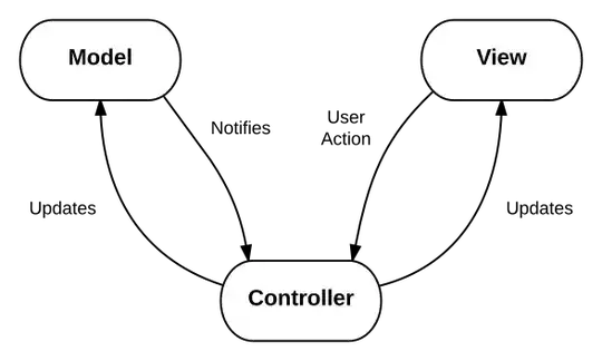

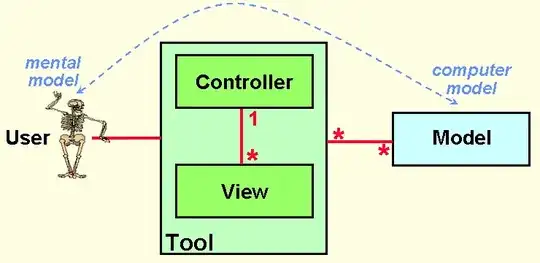

It is a simple idea... You have an object-oriented model of reality, and to access it you create a tool that presents a view and handles the interaction with the user:
Model-View-Controller
It is better to understand with this diagram from Wikipedia:
