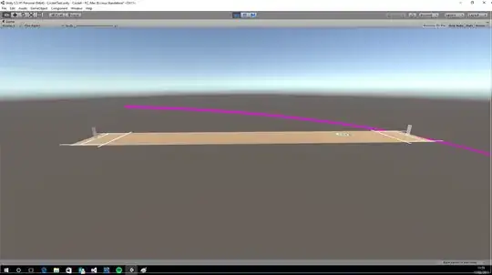

The main things that are wrong with this are, the (x,z) direction is off (see screenshot 1 below). I'm sure that the below is not the best way to do this:
float angleTarget = Vector2.Angle(new Vector2(transform.position.x, transform.position.z), new Vector2(aim.transform.position.x, aim.transform.position.z));
//Set left/right rotation
angleTarget = angleTarget > 90 ? angleTarget - 180 : angleTarget;
//Apply y-axis rotation
launchAngle = Quaternion.AngleAxis(angleTarget, Vector3.up) * launchAngle;
Also, I think that the calculated angle of incline is correct but I am open to other ideas around that.

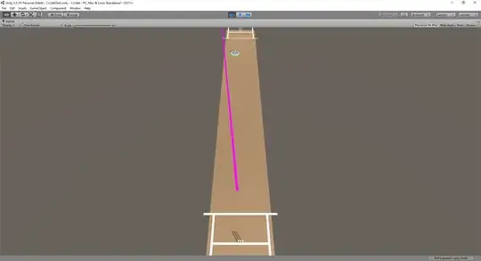

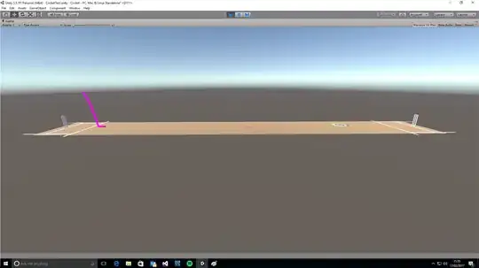

Final issue is with the rigidbody.AddForce(launchAngle * speed);. So the speed is used to calculate the launch angle, but when used as the impulse for the force it barely moves, it looks like screenshot 2. I am using the ratio of 1 unit to 1m in Unity and therefore used a value of 35 for the speed (assuming this to mean 35m/s or approximately 80mph). Upon keeping the speed for the calculation of the angle but changing the impulse of the force to 1000, the ball moves like screenshot 3. How do you get the correct impulse on the rigidbody?

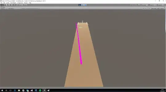

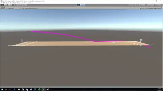

EDIT: I have changed the AddForce to use the different ForceMode values with speed (35). Impulse and VelocityChange look like screens 4 & 5, it has improved the look of the arc, but it is still out (Long and left). Force and Acceleration looks like screenshot 2.

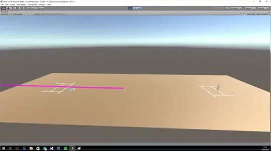

EDIT 2: In relation to @DMGregory I have seen that code and tried to implement it as such:
private Vector3 GetLaunchAngle2(float speed)
    Vector3 launchAngle = Vector3.up;
    float height = -transform.position.y; //Height from 0
    float distance = Vector3.Distance(new Vector3(transform.position.x, 0, transform.position.z), new Vector3(aim.transform.position.x, 0, aim.transform.position.z)); //Distance to target (aim)
    float b = (speed * speed) - (height * Physics.gravity.y);
    float discriminent = (b * b) - (Physics.gravity.y * Physics.gravity.y) * ((distance * distance) + (height + height));
    if (discriminent >= 0)
        float discRoot = Mathf.Sqrt(discriminent);
        float tMin = Mathf.Sqrt((b - discRoot) * 2 / (Physics.gravity.y * Physics.gravity.y));
        float tMax = Mathf.Sqrt((b + discRoot) * 2 / (Physics.gravity.y * Physics.gravity.y));
        float vx = distance / tMin;
        float vy = height / tMin + tMin * Physics.gravity.y / 2;
        //float vx = distance / tMax;
        //float vy = height / tMax + tMax * Physics.gravity.y / 2;
        launchAngle = new Vector3(0.0f, vy, vx);
        //float angleTarget = Vector2.Angle(new Vector2(transform.position.x, transform.position.z), new Vector2(aim.transform.position.x, aim.transform.position.z));
        //angleTarget = angleTarget > 90 ? angleTarget - 180 : angleTarget;
        //launchAngle = Quaternion.AngleAxis(angleTarget, Vector3.up) * launchAngle;
    return launchAngle;
The result of that is Screenshot 6 below, there is a massive problem with that. Screenshot 6
