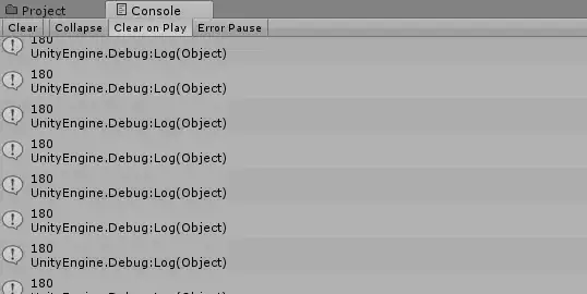

As you can see by my log, the angle returns an exact value of 180, but does not enter the if statement to perform the second log output:
The console prints a <code>z</code> angle of 180 degrees, but does not print the statement in the <code>if</code> statement that directly follows.

  • Change {Debug.Log(transform.eulerAngles.z);} to {Debug.Log((int)transform.eulerAngles.z);} and let's see what's the output in the console. Probably nothing exceptional will appear there, but as everyone are having a hard time with this, let's try something. – Hatoru Hansou Feb 02 '17 at 00:25
The problem is that Debug.Log(transform.eulerAngles.z); printing 180 does not mean that z has the value 180. It means it has a floating point value very close to 180, but that could be for instance 179.999969482421875.
This means that the if((int)transform.eulerAngles.z == 180) test will not work, because casting 179.999969482421875 to int yields 179, not 180.
A possible solution is to round the value: if (Math.Round(transform.eulerAngles.z) == 180.0).

    I agree, but in an initial screenshot I had uploaded, I had shown that the if condition was indicated true by the debugger in mono( the one which appears on hovering over the == sign). Doesn't this mean that the condition had evaluated to true ? – Ikun Jan 30 '17 at 06:35
  • The condition has not evaluated to true, since the code inside was not executed. There may be a problem in the debugger visualiser, but you should first fix your code. – sam hocevar Jan 30 '17 at 09:35

Since you are using a slerp and casting to int, your rotation doesn't actually ever hit 180, since casting cuts off anything after the comma (179.999999999999.. => 179). The Debug.Log rounds instead, so if you want the behavior to be the same try Mathf.Round instead of the int cast.
It is better to use the solution Wondra posted in the comment above though, this is just to make it clear why it broke before.
Nicki
  • 184
  • It does. And the user demonstrated that the if statement is false if((int)transform.eulerAngles.z == 180) , as it didn't write out the Debug.Log("Hurray we have successfully executed the if statement"); but only the rounded Debug.Log(transform.eulerAngles.z); – Nicki Feb 02 '17 at 09:13
