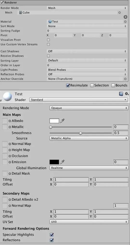

I've got a particle system with Render Mode set to Mesh. Then I applied a material to it, which is just white with the default shader. Now I can't change the start color nor the color over lifetime etc. As far as I know that shouldn't happen, right? I'm using Unity 5.5.0f3
This is what my PS looks like with the material :

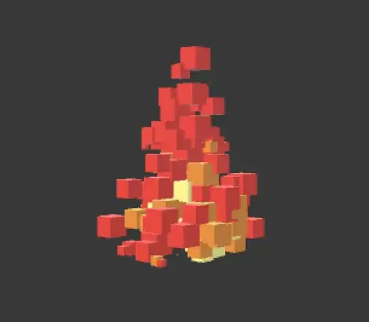

This is what I achieved with 3 particle systems with 3 different materials, but actually, I don't want these materials. Instead, I want to set the start color property of the particle system to apply some color. The material solution restricts me in terms of random start color and stuff like this.

  • Particle colour is introduced via vertex colours. The default particle material reads this vertex colour information, but the default mesh material does not. You just need to use a different material or create your own. – DMGregory Dec 20 '16 at 15:21
  • I use the default shader material actually. Or do I have to create a new mesh with this material applied? – TobiasW Dec 20 '16 at 15:32
  • Try to use one of the Particles materials on your mesh. The default materials in Unity ignore vertex colors. – kolenda Dec 20 '16 at 15:37
  • Okay, works with sprite and default particle material, but how can I make this just a simple voxel particle system .. – TobiasW Dec 20 '16 at 15:40
  • It sounds like you have a working solution. What do you mean by a "simple voxel particle system"? What's currently missing or not working the way you want it to? – DMGregory Dec 20 '16 at 15:58
  • Updated my question for you to clearify that! – TobiasW Dec 20 '16 at 16:41

Animation of a particle system generating many different coloured cubes

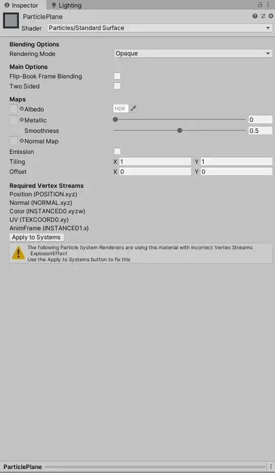

(Sorry for my english, I'm not native) I had the same problem, and what i did was:
  1. Create New Material (i named my new material "ParticlePlane").
  2. Change the Shader in the new material. I assigned Particles/Standar Surface enter image description here
  3. Then in the particle system, in the Renderer module, in the Material property i put my new created material and that's all.
After doing those 3 things, the Color over lifetime module started to work correctly.
Hope it helps somebody.
Regards.
