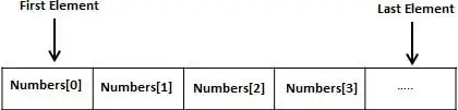

First of all. C is not the same as C++. (They are different programming languages)
Now, (trying to explain without making it too complicated), arrays are lists of variables.
(The image has Numbers with capital letters, my fail, ignore that, shouldn´t have the starting letter in capitals)
For example, int numbers[10]; is an array that contains space for 10 ints (numbers).
You can access values from the array ("list"):
exampleIntVariable = numbers[1];
Our variable will have the value of the 2ND number in our list (The first one is numbers[0])
