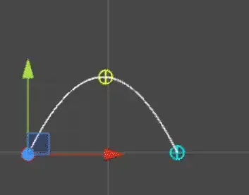

Here's an animation of this method in action, moving the three points freely:
Drawing a parabola through three given points

  • This looks fantastic and more versatile than the solution I came to myself. I'll try implementing it and see how it goes. Thank you! – NoeL Jan 12 '16 at 12:13
