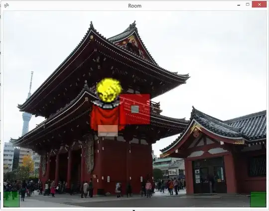

I am having trouble with my 2-D wall-sliding. Namely, when the player avatar collides with the wall, it "snaps" to the corner (see screenshot, below) and sticks there. The red, transparent rectangle is my "wall":
My code is as follows:
"FootRectangle" is your standard xna rectangle. Location is a vector2. The player is moving to a target, which could be anywhere on the screen, which is also a vector2.

How can I resolve these collisions so that the avatar snaps to a corner and smoothly makes his way to the target destnation?
I attempted to implement a similar solution to that at this post; however, it seemed to stick when the collision occurred.
