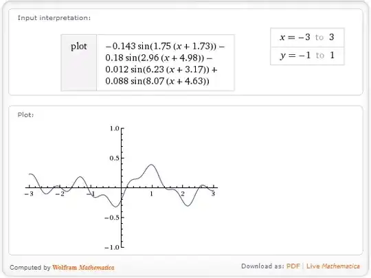

Assuming that you want an actually smooth terrain, I'd suggest stepping back from the noise-based answers and understanding where they come from. A 'noise' signal is essentially a sum of infinitely many sinusoids of random amplitudes, with the 'average' amplitude at a given frequency given by a function of the frequency f. You can get most of the common 'noise' definitions this way. For instance, Brownian motion has a 1/f^2 frequency response (that is, the average amplitude at a given frequency is inversely proportional to the square of the frequency): this means that nearby points have a fair bit of correlation with each other, since the high-frequency components of the signal are heavily damped. By contrast, the classic fractal noise (midpoint displacement, Perlin noise, etc.) has a 1/f frequency response; there's more variance between nearby points, but still quite a bit of correlation. Going a step further, white noise has a constant frequency response - there's no correlation at all between any points.
What good does this do you? Well, you can get a smooth signal that still has a bit of a noisy look to it by just summing a handful of sinusoids but making sure that they have an appropriate amplitude at any given frequencies. You want the frequencies to be 'random' so that no two of them will have a common multiple (otherwise you'll get a periodic component to the overall shape of your hills), so I'd suggest something like the following procedure (complete with working example):
  1. Choose 4 (real) numbers at random in the range [1..10] - these will be the frequencies of your sine waves. I 'rolled the dice' at random.org and got: f0 = 1.75, f1 = 2.96, f2 = 6.23, and f3 = 8.07. There's nothing magical about the number 4 (you can use more, but using any fewer will start to make the individual sine waves more obvious) or the range 1 to 10 here (it'ss just a way of making sure that your highest and lowest frequencies aren't too far apart). It might make sense to choose one frequency in the range [1..2] and the rest in the range [2..10] just so that you have a known 'dominant' sinusoid.
  2. For each of these four (or however many) frequencies fi, choose an amplitude ai somewhere in the range between -C/fi and C/fi for some constant C. The value you choose here controls the overall amplitude of your wave - for convenience's sake, I picked C = 1. Then I needed random numbers in the range [-1/1.75 (= -0.571) .. 1/1.75 (=0.571)], and similarly in the ranges [-0.338 .. 0.338], [-0.161 .. 0.161], and [-0.124 .. 0.124]. Rolling the dice four times again, I got a0 = -0.143, a1 = -0.180, a2 = -0.012, and a3 = 0.088 . (Note that this probably isn't quite the best way to do this step - since the maximum possible value of the function is the sum of amplitudes abs(a0) + abs(a1) + abs(a2) + abs(a3), it might make more sense to divide each of your four ai values by this sum once you've generated them, and then multiply each one by C so that you can be sure the precise maximum the function can attain is C.)
  3. Pick four 'offsets' oi, each in the range [0..2π] (0..6.28) - these will tweak the starting points of your waves so that they don't all begin at 0. I got o0 = 1.73, o1 = 4.98, o2 = 3.17, and o3 = 4.63 .
  4. 'Plot' the function f(x) = a0 sin(f0 ( k x + o0)) + a1 sin(f0 ( k x + o1)) + a2 sin(f0 ( k x + o0)) + a3 sin(f0 ( k x + o0)) - here k is another constant, one that controls the horizontal 'stretch' of your functions. You'll have to figure out what this is for your own application; for convenience I just picked k = 1, and so my overall function is f(x) = -0.143 sin(1.75 (x + 1.73)) - 0.180 sin(2.96 (x+4.98)) - 0.012 sin(6.23 (x+3.17)) + 0.088 sin(8.07 (x+4.63)).
Here's the result of my example run, as plotted in Wolfram Alpha - note that it fixes the size of its graphs for display purposes, but that you should have plenty of control over the horizontal and vertical stretch of the result via the constants I mentioned above:
Simple random sinusoid
