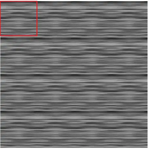

  2. Let Seam_noise be a seamless noise function in the dimension of your tiles. (here is an example , you can download c# code with a seamless perlin noise implementation ) Follow an example of seamless perlin repeated 4X4 times (the red quad is your tile dimension) enter image description here

As you can see is far away from your sample image. You can work on noise quality, in the grid intensity, in the mix function to refine things a bit.
