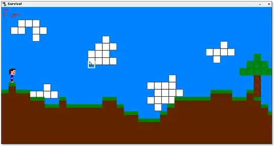

I've been working on a small game, and I've been stuck on the collision part. During the collision, when my player hits a block, he stops just as it should, but it then doesn't allow me to another direction (ex: the collision happens on the y axis, it won't allow me to move along the x axis). What I want is to be able to move along the wall while still moving into it (If you know what I mean). I've checked here and here, but they aren't what I'm looking for.
EDIT: The new code allows me to move along the axis's fine, but I'm getting some different problems (shown in pictures)
This is the NEW code for my collision detection:

And here are some picture based on the new collision:
Falling on ground: Falling on ground
Moving to the left when on top of a block: Moving to the left when on top of a block
Moving to the left: Moving to the left
Jumping when moving right: Jumping when moving right

I've been implementing some very similar collide-and-slide collision detection and resolution. http://metareal.net/blog/wp-content/uploads/2015/08/2015-08-21.jpg
The main key I found was to handle X and Y separately. So, your code might be modified something like this (a little freeform but you should get the idea):
// step 1, modify X
prevX = x;
x += movementX;
work out top, left, bottom, right
if(new span collides with anything) x = prevX;
// step 2, modify Y
prevY = y;
y += movementY;
if(new span collides with anything) y = prevY;
In certain cases, the order of checking x and y will make a difference. Specifically, heading directly onto a colliding corner will now favor X movement. This is probably ok, but can be changed if you need. (Literally a corner case!)
