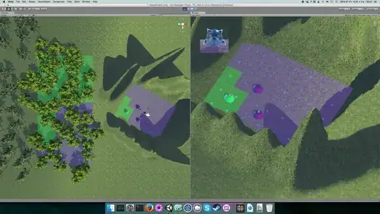

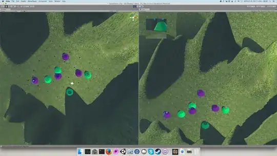

I solved this problem using an hybrid approach, inspired by:
  • my original workaround
  • @Felsir's post
  • @dnkdrone.vs.drones's post
Solution
I have Chunks, which may have an owner or be contested.
  • Inside a contested Chunk, different players have their areas of influence.
  • Instead of using a definite polygon/line border, inside the Chunk itself every player may place Flags.
  • The Chunk itself is dividend into equally distanced ChunkPoints.
  • A ChunkPoint's owner is the nearest Flag's owner.
  • Chunk's % ownership is how many ChunkPoints you own.
first screenshot screenshot with sub-areas
Sources
Using a polygon approach turned out to be too complex because I had to detect the order of the points, and they could with time take very complex shapes, which wasn't obvious how to handle.
I considered using voronoi's before realising that a ChunkPoint map was much easier and equally good for what I needed to do (but trying to use them was the source of inspiration that got me there).
