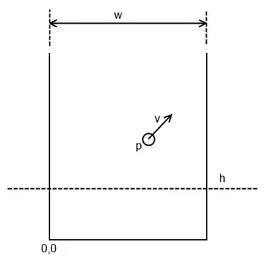

I'm relatively new to games development and I have a 2D game where the playing area is an enclosed rectangle with width w and infinite height. In the playing area there is a ball. A gravity force of strength G acts on the ball. The ball starts at position p and has an initial velocity of v.
How would I calculate the position the ball will be at when it reaches the specified height h. I have a function setup using the following parameters:
bool CalculateXPositionAtHeight(float height, Vector2 position, Vector2 velocity, float Gravity, float width, float& xPosition);
  • The playing area doesn’t have any boundary at the top, so no collision ever happens with it.
  • The ball can be considered as a point.
  • There are no precision issues and everything can easily fit in a float.
  • There is no air resistance.
  • All collisions are perfect without any energy loss.
  • If the ball hits the bottom it won’t bounce.

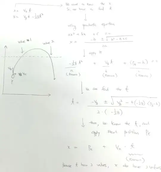

@Richard Byron explained well and gave a well-made sample code.
I think it's better to add additional information about the basic math.
I leaved out the wall collision.
Sorry for bad hand writing an drawing.
physics 2d fomular equation
