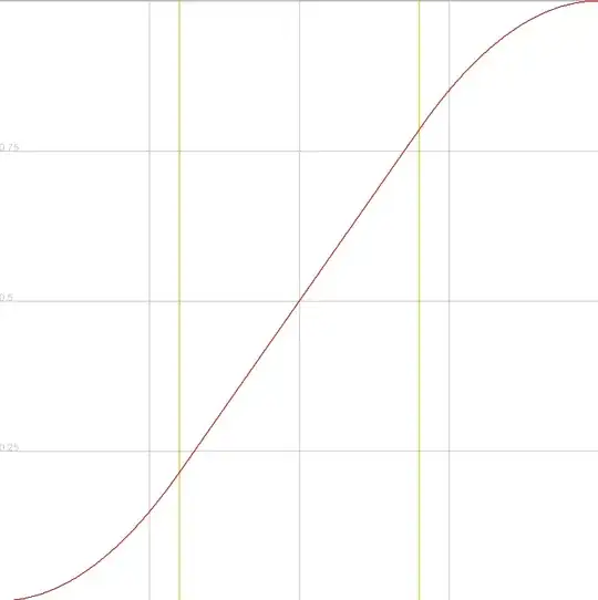

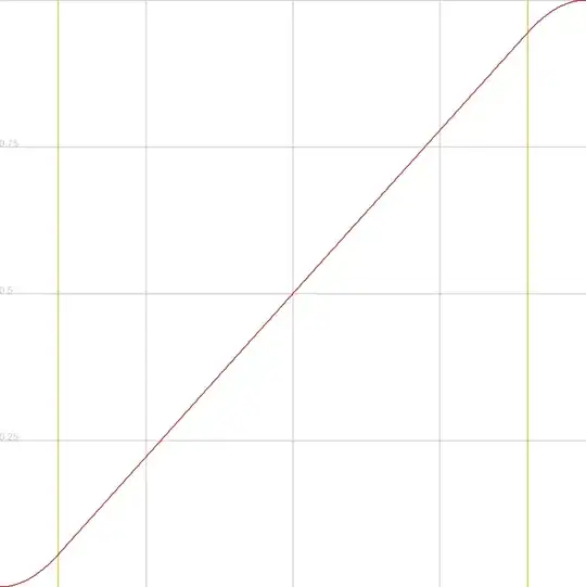

And here are some plots for different values of t_1. Imgur Imgur Imgur
