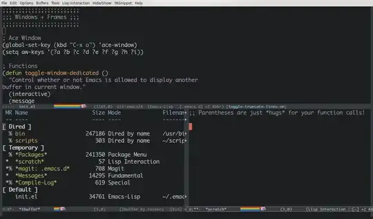

In emacs, more often than i like, I end up with 4 windows or more.
I'll use that example:
|   1    |   2       |
|    3   |     4     |
|        |     5     |
Lots of function can do action in other-window (usually same window pointed by C-x o). Specially useful are scroll-other-window. However, when 4 or more windows are opened, other window is unlikely to be the one I want.
Is there a easy way to manage to do set other-window without changing window/buffer layout ? Of course, it's doable using a bunch of C-x 4 b and C-b but I do not want to change the layout. For example:
  • if editing in window 4 in above picture, is there an easy way to set C-M-v to scroll the window 1?
  • Or simply, suppose the the focus in on window 3 , how to set other-windowto point to window 2 ?

If I read your question correctly, you are mainly interested in operating on buffers displayed in other windows quickly (while preserving the current window layout).
Changing the window that other-window points to is one way of achieving that, but I'd like to suggest an alternative workflow:
Unlike other-window, ace-window allows you to quickly jump to a specific window: When you call ace-window, it shows a unique number in each window. To jump to a specific window, you simply type the corresponding number. If you only have two windows, it puts point in the other window without asking you to type a number. This screencast demonstrates switching to another window, scrolling it, and switching back to the original window:
Demonstration of ace-window
If you bind ace-window to C-x o, you don't have to memorize an additional key binding, and it will feel like you are using a supercharged version of other-window.
Also, if you touch-type and/or prefer not to move your fingers too far away from the home row, you can instruct ace-window to "number" windows using letters instead of numbers (see below).
ace-window is available in MELPA. After installing it via M-x package-install RET ace-window RET, you can put the following in your init-file to set it up as described above:
(global-set-key (kbd "C-x o") 'ace-window)
(setq aw-keys '(?a ?b ?c ?d ?e ?f ?g ?h ?i))
