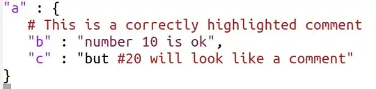

I am trying to add a comment feature to json-mode. A comment starts with a hash sign and ends at the end of the line. However, if the hash sign is inside a string it should not count as the start of the comment. For example:
I am using Emacs 24.4, and installed json-mode from the package manager in Emacs.
Here is a minimal example:

This will highlight comments correctly, but also incorrectly assume that a hash sign inside a string starts a comment. How can I extend the function my-json-mode-comment-highlighter so it works as desired?

(override t) is the culprit: that's what tells Emacs to apply the comment face to anything that starts with a # even if part of that thing has already been recognized as something else. Remove it.
However you shouldn't need to define a regex to highlight comments: Emacs understands comments out of the box, based on character syntax, as described by Lindydancer. It should be enough to declare # as a line comment start character with
(defun my-json-mode-hook ()
  (modify-syntax-entry ?# "< b"))
(and maybe (modify-syntax-entry ?\n "> b") if the JSON mode doesn't already define // as a line comment start.)

    @HåkonHægland, it appears that the JSON mode specifies "keyword only", i.e. skip the syntactic phase. Try adding (set (make-local-variable 'font-lock-defaults) '(json-font-lock-keywords-1)) to your hook. Also, the mode tries to highlight strings using a font-lock keyword, I would recommend that you would remove it and let the syntactic phase take care of it all together. – Lindydancer Mar 05 '15 at 22:55

Naive approach which will do slightly better: disallow quotes after # - #[^"']*$ instead of #.*$. This won't colorize comments containing quote but won't go inside string.
Proper approach: complicate the loop. Scan the line searching for any interesting special characters (those are ", ', \ and # unless I miss sth), keep track of whether you are inside some quotes, and find first # which is not inside quoted string.

I agree with @Lindydancer that the best way would be to use the built-in syntax highlighting for highlighting comments. But in order to that, I think I would need to modify the source code of json-mode.el. Since I did not want to modify the source code of json-mode, I tried to do work around this using font-lock-add-keywords instead. It becomes a little bit complicated, but here is something that seems to work for me now:
