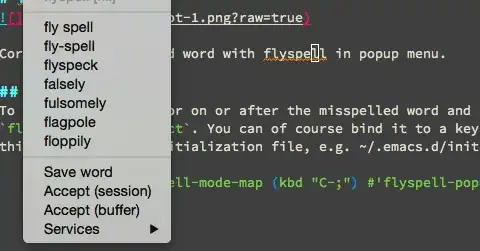

To correct misspelled word at point, both built-in M-$ (ispell-word) and C-c $ (flyspell-correct-word-before-point) works great, the former uses a buffer to show correction choices, while the later uses a GUI popup menu:
Running flyspell-correct-word-before-point on "flyspell"

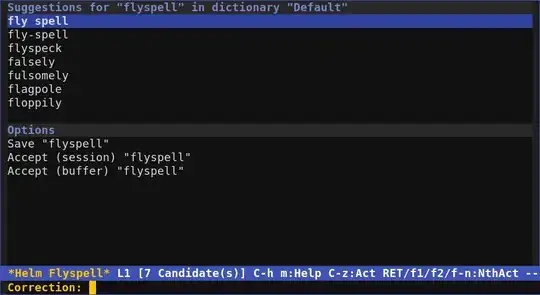

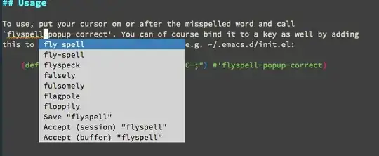

There are also some other interface like popup and helm:
flyspell-popup:
flyspell-popup demo
helm-flyspell:
