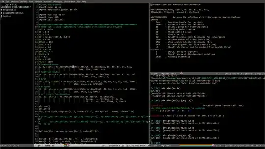

Especially in larger and/or scuttered projects refactoring is super important not to break something. Does someone know how to setup emacs-traad with Spacemacs? – thinwybk Sep 25 '19 at 09:47
I use purpose-mode. This allows you to define a pretty robust environment.
Using elpy
, pydoc
, and neotree
I have a pretty robust environment (in the sense that windows don't do strange things at errors). This can also work pretty well with gud-pdb
for debugging.

The answers here have provided most of the important features that spacemacs provides but there was always one feature that I could not find about -- DEBUGGING(I did not find any decent debugging tools that go on well with spacemacs until very recently)
So how did I setup a debug workflow for my spacemacs?
There is a feature branch under development that uses realgud.el package to provide a close to IDE like debug experience in spacemacs : https://github.com/CeleritasCelery/spacemacs All you have to do is pull this branch into your .emacs.d directory and make some changes in your ~/.emacs.d/layers/+lang/python/packages.el file
Detailed Steps to setup spacemacs for debug ( Take a deep breath )
- Type the below commands in your terminal one by one. This will add CeleritaCelery's spacemacs changes in a separate branch named 'debug-layer'. This means that if anything gets messed up you can always checkout the master branch and voila! your original spacemacs is back!
remote add debug-layer https://github.com/CeleritasCelery/spacemacs
fetch debug-layer
checkout --track debug-layer/debug-layer
branch -a
Now open the ~/.emacs.d/layers/+lang/python/packages.el and add the below function to the end of the file
;; configure trepan3k as the python debugger to be used with realgud (defun python/pre-init-realgud() (dolist (mode '(anaconda-mode)) ;; bind trepan3k with anaconda mode (spacemacs|add-realgud-debugger mode "trepan3k")))
This function uses the trepan3k debugger as the python debugger. You can change the value to pdb or ipdb or whichever debugger you like. If you plan on using trepan3k make sure you install it with pipsudo pip install trepan3k
as it does not come pre-installed with your python distribution.Now open your .spacemacs file and 'debug' layer inside dotspacemacs-configuration-layers like this
dotspacemacs-configuration-layers '( (python :variables python-enable-yapf-format-on-save t flycheck-disabled-checkers '(python-flake8) flycheck-checker 'python-pylint ) debug )
- Then restart spacemacs and open any python file You can start debugging by typing M-x realgud:trepan3k
This will start the debug session and you can add,delete breakpoints using realgud keybindings explained here : https://github.com/realgud/realgud#source-window-commands
You're done!
