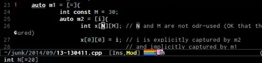

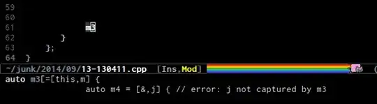

  1. You don't need to jump back to local definition to see the details. Simply using semantic-idle-summary-mode, it will show definition of any variable/function/class/struct at point like this, automatically:
Demo 1:
semantic-idle-summary-mode1
Demo 2:
semantic-idle-summary-mode2
Demo 3:
semantic-idle-summary-mode3
As you can see in the screenshot, the function signature of find_if is shown in the minibuffer.

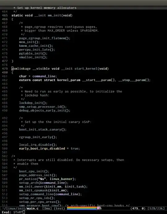

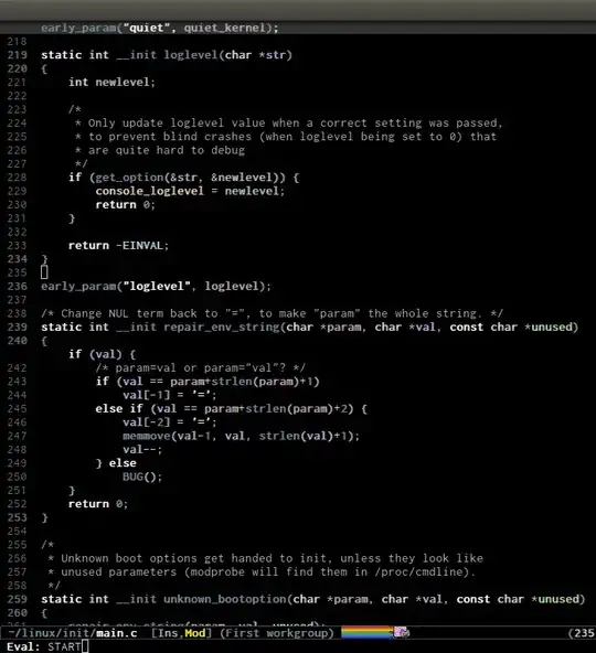

You can also keep the definition of current function always visible at the top like this:
semantic-sticky-func-mode
To enable those features, add this configuration to your init file (either ~/.emacs or ~/.emacs.d/init.el:
(semantic-mode 1)
(add-to-list 'semantic-default-submodes 'global-semantic-stickyfunc-mode)
(add-to-list 'semantic-default-submodes 'global-semantic-idle-summary-mode)
