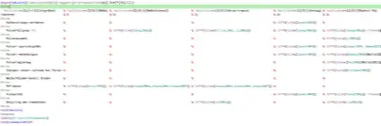

I'm working with large LaTeX tables in AucTEX and it would be helpful to display them in truncated lines, like here:
The red marks are the "&" characters which separate the columns of the table. In case of tables with many columns the latex source code for one table row is longer than the emacs frame width and therefore will be by default wrapped into more than one line. Even with align-current, this will make the table source code very hard to read and edit, so
  • for tables I'd prefer the source code lines to be truncated (forcing me to scroll horizontally)

    That image is illegible. Please describe with text exactly what you mean - "like here" doesn't cut it, in this case. – Drew Feb 17 '15 at 15:33

  • @Drew: sorry for the image, I've added an explanation to the question - the point is that if I have a latex table with lines longer than the frame width and use word-wrap, it will be hard to read, as one row is displayed in more than one lines in the source code. – MostlyHarmless Feb 17 '15 at 16:07
