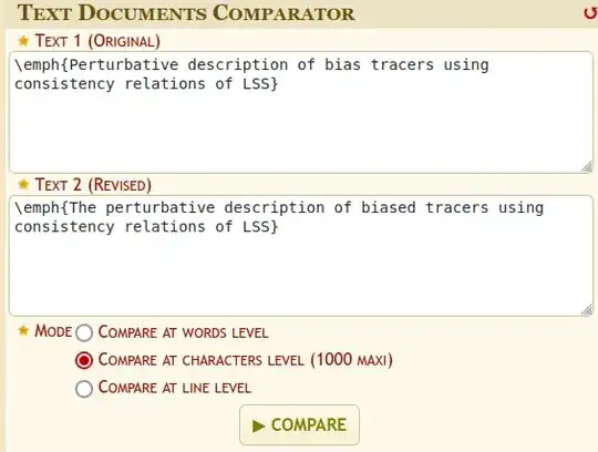

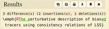

Searching on Google, I found this website: https://www.dcode.fr/differences-2-texts. It allows "visually" comparing two text strings at the character level,
returning a result like this:
My question is: is there any function or package that allows doing the same thing directly in Emacs?
The function should take the two strings as arguments and return the "fontified" comparison string or show the result in a dedicated buffer.
I would need to use the function something like this:
(emacs-text-compare-bla-bla "String1" "String2" 'character-level)
without the need to manually select the strings to compare.
Note. I would really prefer to have a fontified string as output, like in the example, so that I can easily view/insert it without the need for additional buffers. If I were to have the output in a buffer, it should be a single window, not two as in the case of *diff* functions.
