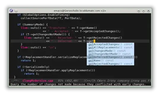

Disclaimer: I'm the author of irony-mode
company-irony screenshot
If you just want smart auto-completion, I can recommend irony-mode with company-irony.
  • irony-mode is easy to install thanks to MELPA
  • the completion is very accurate and the performance quite decent thanks to libclang
  • with company-irony you have an asynchronous completion backend that will not get in your way if the completion takes some time
  • company-irony supports overloaded functions and if you have Yasnippet installed the function arguments are inserted as placeholders to fill-in
  • if your project uses Doxygen, the brief documentation of the completion candidate is displayed in the minibuffer (see screenshot)
  • the installation of irony-mode server on a Unix-like system (Linux, OS X) should be easy. Windows on the other hand requires a bit of tweaking but it is documented in the wiki
