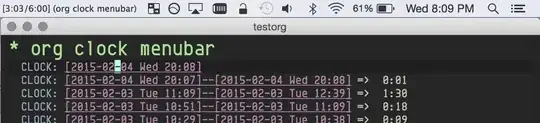

Solution for displaying the org-clock information in the OSX menu bar
Here is an alternative solution to the problem you specified:
I use apps other than Emacs, so when I switch to them (e.g.. when using the browser or terminal) I still want to be able to look at the running timer.
You can use this to display the information from org-clock in the osx menubar which you should almost always be able to see.
https://github.com/jordonbiondo/osx-org-clock-menubar Available on MELPA
Note that this requires macruby.
What it looks like while clocked in.
