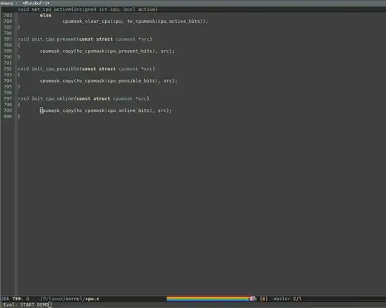

Here is a demo (it starts when you see START DEMO at the bottom):
projectile-semantic-insert-function-prototype
You can also use only Senator to copy and function prototype. As long as point is anywhere inside the function signature or function body, run senator-copy-tag, which is bound to C-c , M-w by default, it copies the whole function: both the signature and body. However, you can paste only the signature if you want by running the command senator-yank-tag, which is bound to C-c , C-y by default. Pressing C-y paste the whole function signature along with its body. senator-copy-tag even works with function signature expanded on multiple lines like this:

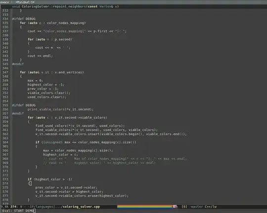

EDIT2: Here is an example for smart insertion of function prototype using Semantic tags. Currently, you can only insert based on the relative positions ("before" and "after") of top level Semantic tags. I will update to make user to be able to insert in any place where Semantic tags are available, with more positions (i.e. when a tag is a Class, it should offer additional positions: public, projected and private). The demo starts when you see START DEMO at the bottom:
