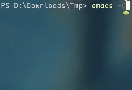

  • scroll-margin is 1 but Emacs still sometimes allows the cursor to stay at the 1st line of a window.
Follow these steps to reproduce it (or see the GIF below):
  1. emacs -Q
  2. In buffer *scratch*, C-x C-e:
    (progn
      (custom-set-variables
       '(custom-enabled-themes '(modus-vivendi))
       '(global-tab-line-mode t)
       '(scroll-margin 1)
       '(scroll-conservatively 101))
      (info-emacs-manual)
      (end-of-buffer)
      (goto-line 500))
  3. With the cursor now at the 2nd line from the top of the window, press <up>-arrow-key several times and pay attention to resulting cursor position.
This behavior is inconsistent with the documentation (and has caused me great trouble in practice):
C-h v scroll-margin:
Its value is 1
Original value was 0
Number of lines of margin at the top and bottom of a window.
The correct behavior is what next-line does;
You can try the <down>-arrow-key after step 3 described above:
Q:
Why doesn't the setting of scroll-margin work here?
IOW, what causes previous-line to move the cursor beyond the margin (which is inconsistent with next-line's behavior when Emacs automatically scrolls up)?
