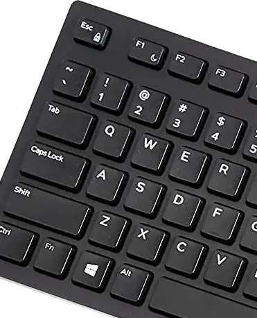

The keyboard I have matches this diagram:

What is the right way to swap the Escape and Backtick keys? Only inside of emacs. Also, I don't want to remap my keyboard in my Windows or Linux OS, I've done this in the past and it causes problems with KVMs (mostly this was with mapping CapsLock to Control).
