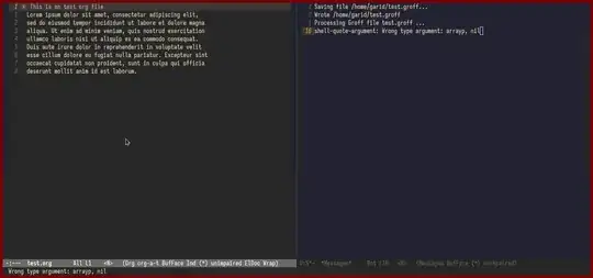

M-x org-groff-export-to-groff works fine (exports .groff file for the org-file)
However, when I try to compile pdf from org-file with (M-x org-groff-export-to-pdf) following error show:
Saving file /home/garid/test.groff...
Wrote /home/garid/test.groff
Processing Groff file test.groff ...
shell-quote-argument: Wrong type argument: arrayp, nil
Could you explain what go wrong?
