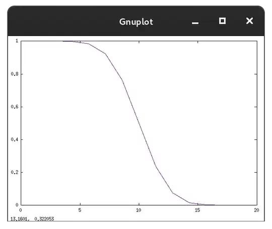

Graph that function; it doesn’t have much slope at 1:
[0 .. 20]
' utpn(x,10,1) RET
g a C-u g p
Newton’s Method uses the slope to determine what guess to try next, so I guess it’s not that surprising that it would fail in this case. The number in the error message is the next guess that Newton’s method wants to make, based on the derivative at the previous guess. Since you know that the answer is 10, you can see how far off it has gotten.

Here's what the curve looks like (obtained with Calc: [0..20] 'utpn(x, 10, 2) RET g f):
You need to choose a starting point as far away from the tails as possible: anywhere within a standard deviation from the solution would be OK, but if you are outside by a few standard deviations, Newton's method is going to at best converge very slowly.
For utpn(x, 10, 2) - 0.5 (which Calc implicitly equates to 0 in order to solve it), I get convergence for initial values between 7.23 and 12.79 (there is a slight asymmetry between left and right offsets from the mean, which I'm blaming on accidents of implementation of the algorithm and the finite arithmetic that any computer does, but I don't know for sure):

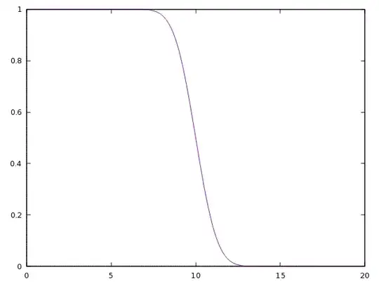

As pointed out in both NickD's answer and dbx48's answer, calc is having difficulty due to the extremely flat portions of the utpn function. Let's graph utpn(x, 10, 1) for x over the range [0..20]:
[0..200]
' utpn(x, 10, 1)
g f
utpn(x, 10, 1) across the range 0..201
You can see that outside the range of about [7..13] the function is very flat.

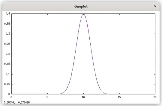

Let's plot that derivative over a range of [0 .. 20]:
[0..200]
' 0.398942280401 / exp((7.07106781188 - x / 1.41421356237)^2)
g f
Graph of derivative of utpn(x, 10, 1) over the range 0..20
The derivative is nearly zero outside of the range [7 .. 13]. Numerically, the derivative approaches zero asymptotically, because utpn itself asymptotically approaches zero.
