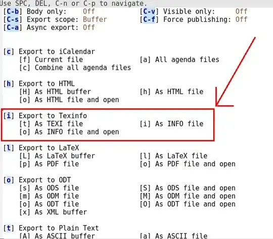

Don't waste your time learning TexInfo ... instead rely on org-mode to create texi and info files.
FWIW, The Org manual itself is written in org and gets exported via ox-texinfo to texi and other formats like info, html and pdf files.
Do
(require 'ox-texinfo)
and while visiting a org file, do C-c C-e i o.
If you take a look Org mode's Makefile, you will get recipes for converting texi files to html and pdf.

If you are interested in creating Table of Contents ...
When in an org buffer do
C-c C-e d #
and make sure that the option toc has value t.
If you are interested in creating index-es look for #+cindex, #+vindex etc in the org-manual.org.
