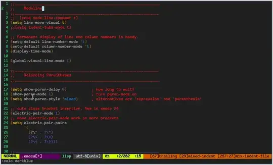

I really need this but couldn't figure out how to do it. Let's say I open a file in a new buffer which has 200 line of code. Now I'm in the beginning of my file in line 1. And Mode line showing All(1,0). Which indicating the current line and column number. Now beside this I want to see my total line number in this file which is 200.
I know there's Another alternative, to press Alt + SHIFT + > keys and that will make emacs jump to the last line of the document or file. But that's sufferable, each time entering a newline gives total number of line increase.
That's pretty much annoying because after going to the end of file i lost my position where i was. And making my way through back takes a lot of time.
So, it'll be a life saver for me if anyone can help me here Here is an example of my neovim mode line, what i'm trying to do in my emacs mode too.

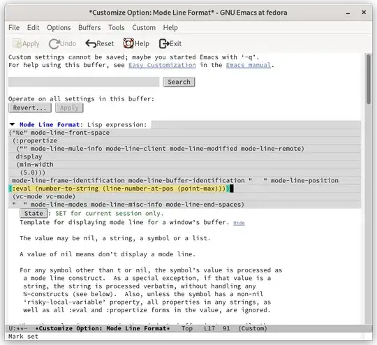

EDIT in response to the comment
Just paste the code on the same line before (vc-mode vc-mode) like in the screenshot below, where Emacs automatically created a new line for it (I have changed the count-lines to line-number-at-pos version here):
Again, don't forget to press C-c C-c in the customize buffer to apply the settings. The total line number will show up immediately in the mode line (like in the screenshot, the number 91 next to L17).
END EDIT
I have found all kinds of posts about this subject (see links below), they currently seem kind of irrelevant to me (for example, about the efficiency of determining the total number of lines, the answers might be outdated). So in summary, currently I would suggest as the simplest solution to simply use M-x customize-variable mode-line-format to add the following form after the mode-line-position (assuming you are using close to vanilla Emacs):
(:eval (number-to-string (count-lines (point-min) (point-max))))
Don't forget to apply the setting by pressing the apply button in the customize interface (or press C-c C-c there).

  • brother i didn't get this. where to put the code? (:eval (number-to-string (count-lines (point-min) (point-max)))) I go to mode-line-position and there one thing call State where can i write. I there I suppose to put those code line ? NOTE: I'm very much noob. – Likhon BaRoy Sep 04 '22 at 08:03
  • Thanks a lot that was life saver for me . I got another problem, I wish if you could see, I'll get the solution here too. please check this one here : https://emacs.stackexchange.com/questions/73424/how-to-set-crossline-alike-highlighting-mode-in-emacs?noredirect=1#comment119329_73424 – Likhon BaRoy Sep 04 '22 at 15:15
