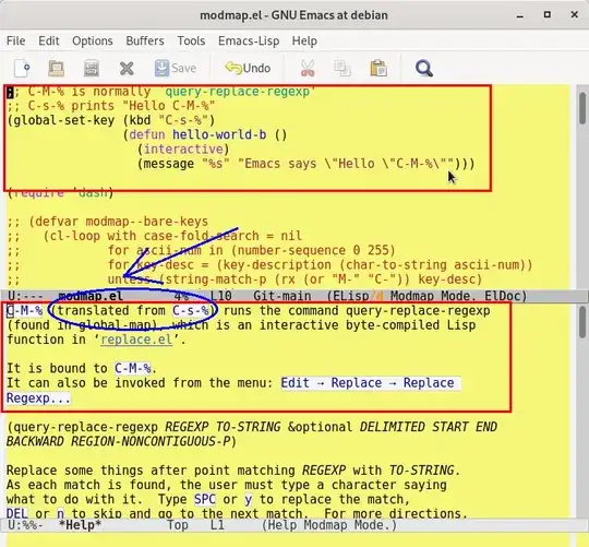

  1. Now do M-x modmap-mode. You will see the following buffer popup, and it tells what the command just did.
M-x modmap-mode
  1. Try M-x, C-M-%. See what happens.
  2. Try s-x, C-s-%. See what happens.
  3. Try C-h k on above keys. See what Emacs reports.
M-x modmap-mode in action (1)
M-x modemap-mode in action (2)
  1. Do s-x modmap-mode, and try the above steps once more. See what happens.
The M-x modmap-mode essentially "swaps" M- and s- keys.
