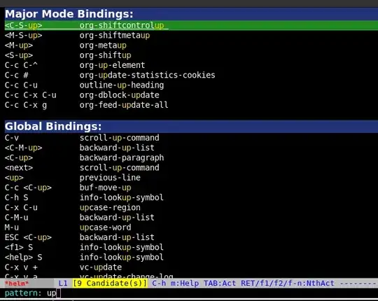

I use the command helm-descbinds, which is available via melpa. I mapped it to C-h b because it is basically a drop-in replacement for describe-bindings. The benefit is that it is easier to navigate and search than the output of describe-bindings because you can easily search for keywords and the helm buffer will narrow to show all of the matches, and which mode they come from
helm-descbinds in action
For any selection in the list, you can choose to either perform the action, or to jump to the documentation for the command.

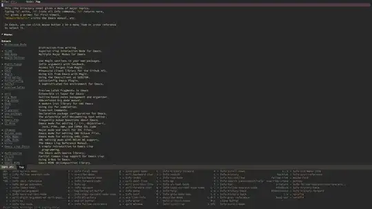

Currently, probably the best way to discover keybindings is by using the which-key package. This package is central in distributions like Spacemacs and Doom emacs.
It provides various commands for discovering available keybindings, e.g. which-key-show-top-level and the which-key-show-(full)-major/minor-mode(-keymap)s.
The which-key buffer can be shown persistently by setting which-key-persistent-popup to t.
Here is a screenshot of the Info-buffer in Spacemacs with which-key showing the major mode keybindings:

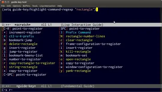

Although not exactly what you are looking for you might want to try out guide-key. If you enter a prefix sequence without completing it guide-key will pop up a buffer showing you the available completions and what functions they execute. I find this very useful when I need to learn new bindings in Emacs.
