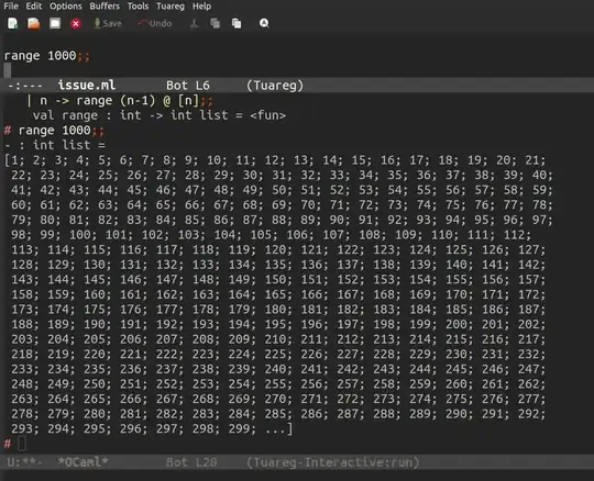

EDIT: My apologies, I'll add some clarification. The problem itself isn't in the code, that was just an example, but I'll elaborate further.
The function range is the following:
let rec range = function
    1 -> 1::[]
   | n -> range (n-1) @ [n];;
it simply prints n natural numbers. So I evaluate that by pressing either C-c C-e, or C-x C-e, or even evaluating the entire buffer with C-c C-b (I've tried all of these and it doesn't make any difference for this particular issue) and this is the output:
# let rec range = function
    1 -> 1::[]
    val range : int -> int list = <fun>
Nothing strange there. Now if I write
range 10;;
and evaluate it with C-c C-e (or any of the other options I wrote above), what appears in the buffer is:
# range 10;;
- : int list = [1; 2; 3; 4; 5; 6; 7; 8; 9; 10]
Again, nothing strange. But if I try:
range 1000;;
the output shown in the buffer is as I've shown in the original question, truncated. It's not an issue in the actual output of the range function; the function does return a list with the first 1000 natural numbers. This is easily verified by checking how many items there are in the list returned by the range function, for example by using List.length:
# List.length(range 1000);;
- : int = 1000
The problem is, the output is not shown in the buffer. I'll include a screenshot, because I don't know how else to explain it.
truncated output

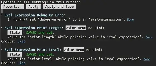

As for print-length and print-level, I did try changing them from emacs settings. Now I'm not very confident I've done everything correctly, but even setting it to infinite, it doesn't work. Here is another screenshot:
print settings
It probably doesn't work because it only applies to Lisp, but I'm working with Ocaml.

Emacs just shows what the OCaml toplevel prints. You need to configure the OCaml toplevel by issuing a #print_length directive (and perhaps also #print_depth). Tuareg mode doesn't have any particular way to do that. Put the directive in the .ocamlinit file in the current directory.
(* .ocamlinit *)
#print_level 999999;;
#print_depth 99999;;
